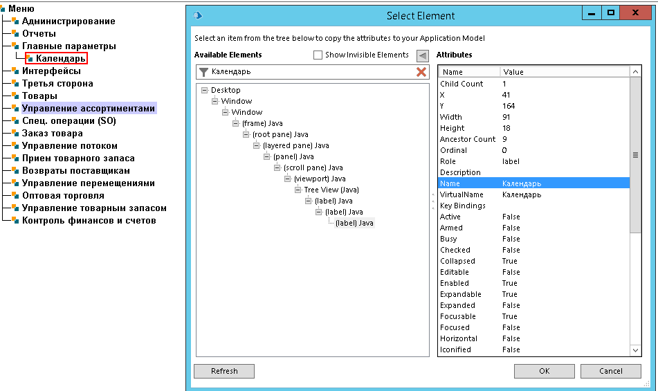

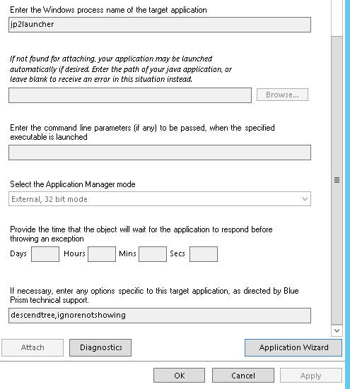

I'm trying to spy elements in an applet application in a browser IE Explorer 11
JAB Enabled, jre1.8.0_251 32-bit, OS 64-bit
Attach successfully.
After authorization in the browser the main application menu opens
All elements become available in the tree after they are displayed on the screen

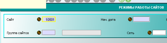

Next, go to the desired application item. It opens in the same tab in the browser

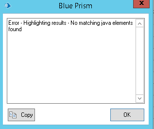

Turn on Spy Java Mode, it appears to get all the elements with attributes.
But after that, the highlight and actions with the element do not work
Please, Help me! How can I finally get these items?
