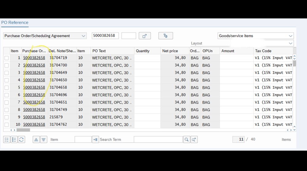

Good day,
Automating SAP POs
Have spied a table and now attempting to click on the PO Number but there are no actions for the table.
Problem: unable to spy the PO number as an element.
How can I dynamically "click text" on a SAP table to open the desired PO.
Surface/region mode automation is an absolute last resort on this one

Dear Rama,
How have you been? Long time .... If you cannot place me, I had the pleasure of working with you at Sasol .... Here are some thoughts:
If BP is not picking it up as a grid, try narrowing the search to the single line you want .... I don't thing we will need region mode here .... What exactly are we trying to achieve here?

Hi Ramashita,
Are you using the SAP Spying mode ?
You can find details here on how to enable SAP Spying mode : https://portal.blueprism.com/customer-support/support-center#/path/Automation-Design/Application-Integration/SAP/1139622862/How-do-I-enable-SAP-Spy-Mode.htm
