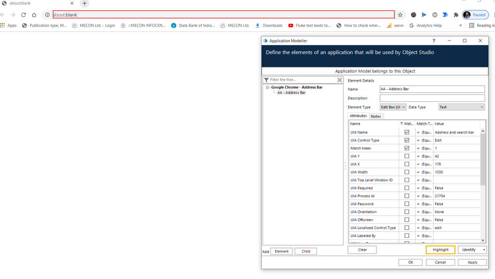

Hi Carolina,
You can use the UIA mode to spy the address bar control in Chrome as shown in the below screenshot. Here, the control type, match index and UIA name seems fine to use. You can even remove the UIA name if you want, still would work fine. Hope it helps. :
![15979.png 15979.png](/t5/image/serverpage/image-id/16140i322059A94298B6C1/image-size/large?v=v2&px=999)
