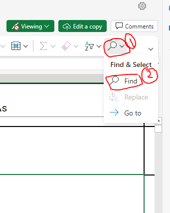

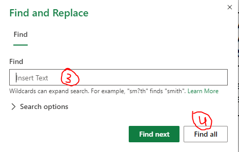

I need help, I have an online Excel sheet on (https://view.officeapps.live.com/) I want to get a spy element for it, But after I capture the element and execute the Bot it doesn't click on the element.
below is what I want to capture:
I want to search in the excel sheet and get the result of the search.
Thank you.

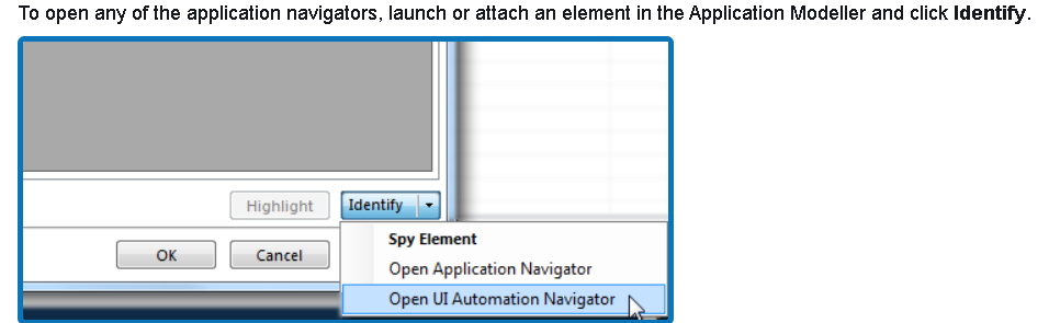

I'm unsure what mode you are using to spy or the attributes for the elements you are trying to use.
Try using UI Navigator to SPY and select the elements.
For more information on UI Navigator, please check this link for Online Help.
