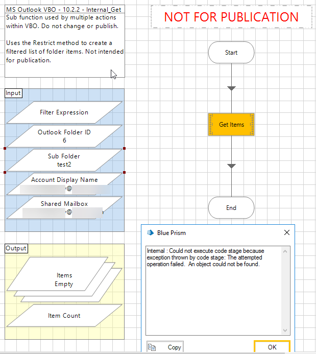

we are not able to get the received emails from the subfolder of one of our shared mailboxes since the beginning of this month. We tried MS Outlook VBO 6.10.7 and the newest one 10.2.2 both and removed all the filter expressions. Getting emails from the inbox directly works, from the subfolder under the inbox however doesn't.
We already enabled the
Use Cached Exchange Mode and Download shared folders.
Blue Prism Version: v7.1.1
Outlook VBO versions: v6.10.7 & 10.2.2
Does anyone have a solution please? Many thanks.

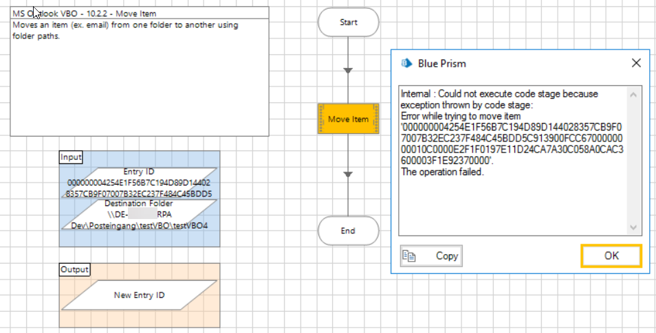

After the two lines were added in the Global Code section, I can move the emails from the inbox of the shared box mentioned above to one of its subfolders by the action Move Item with the bot account now. But I still get the "operation failed" error with my AD account for Windows and my business mailbox for Outlook.

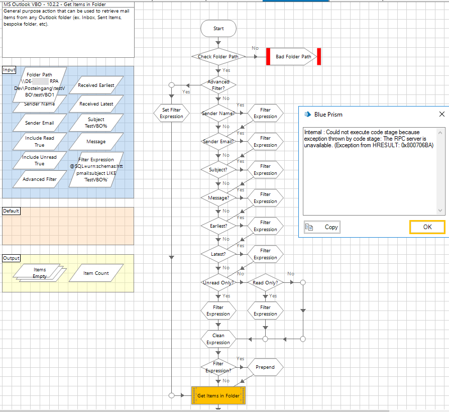

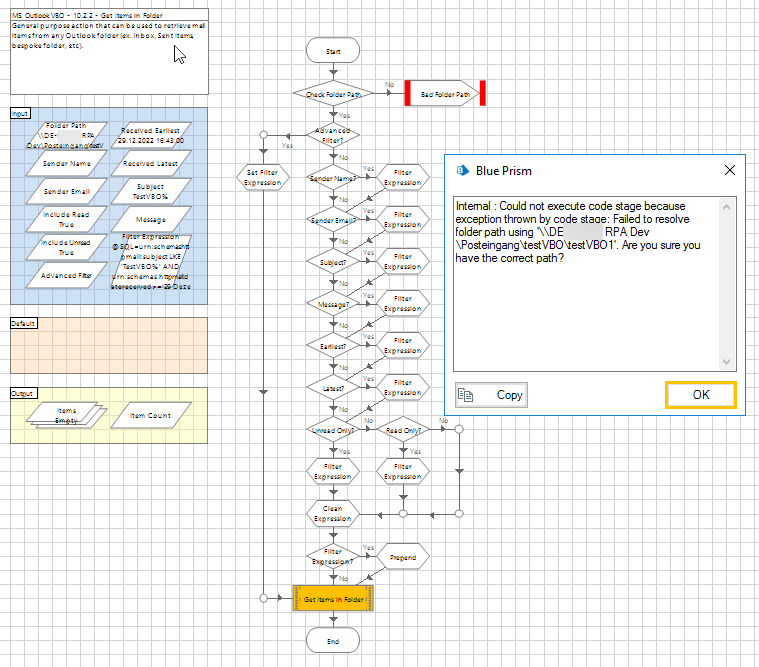

On the other hand, I tested further the action Get Items in Folder. All the paths (\\DE- ***DEV\Inbox\testVBO\testVBO1, 2, 3, 4, 5) are correct which were proved by the action Move Item.
I can get the emails from testVBO1 eg. with my AD account for Windows and my business mailbox for Outlook. But I got one of the following errors ​​with the bot account instead while testing:
35205.png35206.pngThe RPC server should be the current running server. I saw no errors on it with my AD account or the bot account. Other Outlook VBO actions such as Send Mail worked.

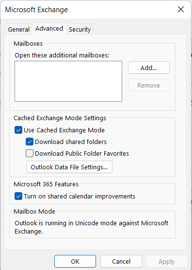

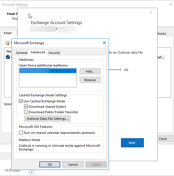

Given that this started after the migration of your accounts to Exchange Online, I'd suggest checking the status of the Use Cached Exchange Mode and Download shared folders options for each account again. I know you said they're enabled, but just verify that they are enabled for your business account and not just the bot account. That's the only thing I can think of that would cause issues with getting access to folders.
If they are enabled try disabling and restart Outlook. Then re-enable them and try again. If that doesn't solve the issue, you may need to consider looking at the Microsoft 365 connector for Outlook. It uses the Microsoft Graph API to work with Exchange online instead of trying to work through the local Outlook instance.
