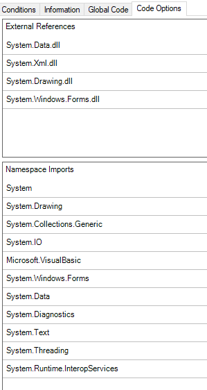

Upon investigating the Code stage, no such errors seem to exist. I've searched previous posts for this and it was suggested that a missing DLL could be the cause, but from the documentation, it doesn't appear as if this VBO requires any additional files. These are the listed dll's established:
