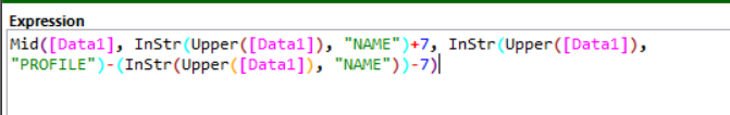

If it's a one line string, you can use the below expression in a calculation stage. Assuming your input is saved in a Data Item called "Data1" and there is a space before and after the colons as the example you provided. This should be giving you an output of the name as it lies between "Name" and "Profile" words. I added a screenshot and the exact syntax for easier copying.
Mid([Data1], InStr(Upper([Data1]), "NAME")+7, InStr(Upper([Data1]), "PROFILE")-(InStr(Upper([Data1]), "NAME"))-7)
You can modify the words and the numbers to get different values.

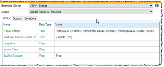

If you look in Blue Prism's "Utility - Strings" VBO , there is a nice little action called "Extract Regex All Matches" (you might have to pull a later one from the Digital Exchange depending on your version of the VBO) which allows you to extract values into a collection using a Regex pattern with capture groups. For the example above, the following Regex pattern would extract the values:
Name\s:\s(?<Name>.*)[\r\n]+Profile\s:\s(?<Profile>.*)[\r\n]+Age\s:\s(?<Age>.*)[\r\n]+
The action would look like the following:

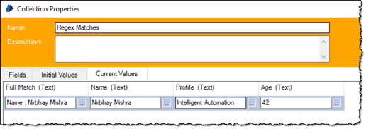

The output collection would be:
With that you can simply refer to the collection fields [Regex Matches.Name], [Regex Matches.Profile] and [Regex Matches.Age] to get your data.
The real neat thing about this action though is that if you have a document with multiple sets of that same formatted data, the action can extract each set into it's own row in the collection.

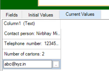

09-01-23 01:10 PM

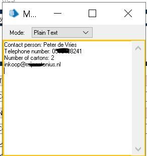

Hi @EslamGhandour above is the screenshot of the value inside the data item I am talking about.
I need to fetch Contact Person, Telephone number and Number of cartons from this data item.
Can you please help how can I achieve that ?

09-01-23 01:32 PM
Hi @NirbhayMishra

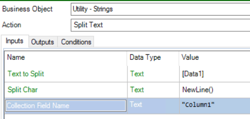

You can use the "Split Text" action from "Utility - Strings" Object. If you don't have the object, you can get it from here.
It should look like this
And your output will be like in a collection like this

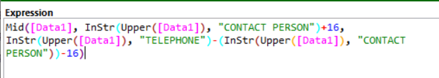

Alternatively, you can use calculation stage that will look like this,
Mid([Data1], InStr(Upper([Data1]), "CONTACT PERSON")+16, InStr(Upper([Data1]), "TELEPHONE")-(InStr(Upper([Data1]), "CONTACT PERSON"))-16)
This exact calculation stage will give you the exact name. The way it works that it gets you everything that is between the words "CONTACT PERSON" and "TELEPHONE".
You can apply the same logic by changing the words you're searching for and as well the number of digits which is 16 in the previous example. You might want to reduce it or increase it.
Hope that helps.
09-01-23 02:00 PM
The following Regex pattern would probably work for you:
Contact\sperson:\s(?<ContactPerson>.*)[\r\n]+Telephone\snumber:\s(?<TelephoneNumber>.*)[\r\n]+Number\sof\scartons:\s(?<NumberOfCartons>.*)[\r\n]+
The differences between my pattern and yours is:
- The Named Capture Groups "?<CaptureGroupName>" cannot contain spaces. The name can contain an underscore instead of a space but I am a CamelCase person so you never see me using underscores.
- The "\s" is a shorthand character class for for white space. Most of the time you can just use a simple space but I have been caught so many times with a tab that I've conditioned myself to use the "\s" instead.
