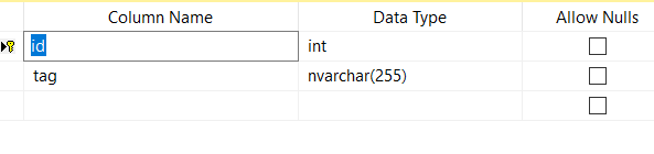

- BPATag: This table is the master table consisting of all the tags that you have used in your work items. Here there are two columns called 'id' to uniquely identify each tag and 'tag' column which consists of the tag value being used. Here the tag value can take a maximum length of 255 characters as per the database schema which you can see below:
So ideally, it should take 100 characters but keep in mind one should be using tags with sensitive data or data that can be redundant or difficult to produce any meaningful MI reporting purpose.
