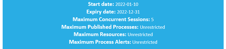

Hi Mohammed,
If you look at the Licence email that you received, if it is a purchased license you can find the information on concurrent processes in the body of the email as seen below.
For a trial or learning license this is set to 2 concurrent sessions by default.
I hope this helps.
