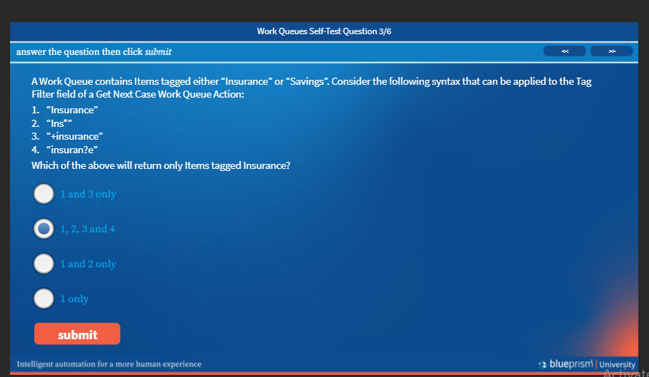

So Tag Item Filter is not case sensitive?

Hi Sanaa,
You are right tag filters are not case sensitive. You can also check the same while adding any item in the queue with a tag and applying filters in Control Room as shown below:
