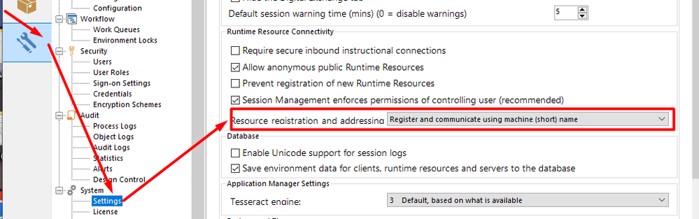

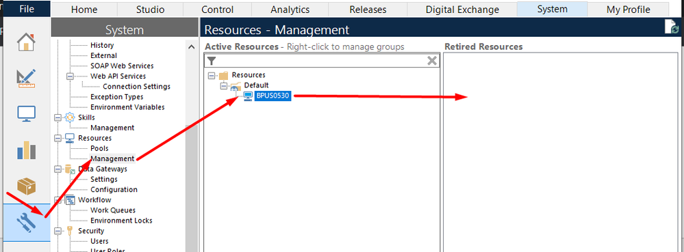

It is possible that change the server configuration from short names to FQDN, for this reason, they are duplicates. Retire the duplicates RR from the enviroment.
Just drag and drop the RR to the Retire window on the right side.
