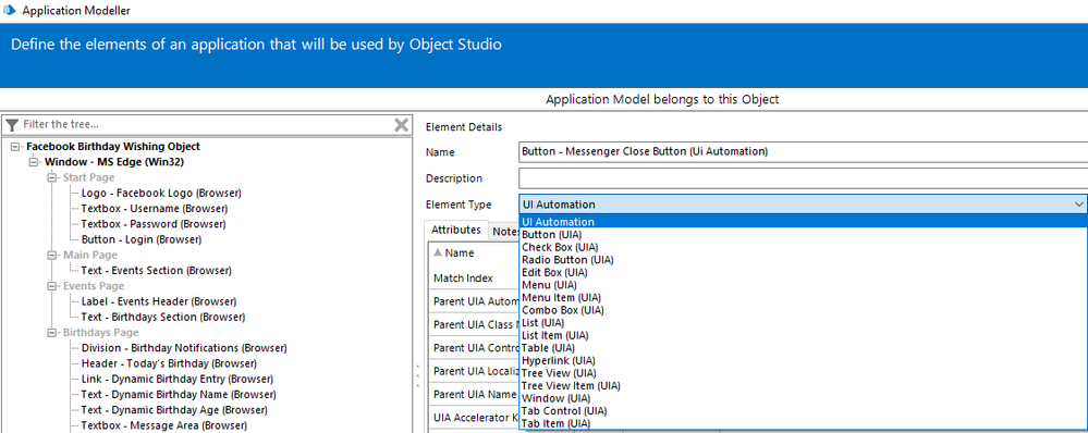

Have you tried to put a wait stage before this action. This exception message can occur if your target element has not loaded properly or if it's schema is corrupted somehow while deciphering the attributes. You can try to induce a small delay before this and check once.
Another thing can be that sometimes some actions may not be compatible with the element that you are trying to automate here. Can you try to change the element type from the application modeler once and see how it goes from there?
![27990.png 27990.png](/t5/image/serverpage/image-id/28123i014058A805B7885D/image-size/large?v=v2&px=999)
