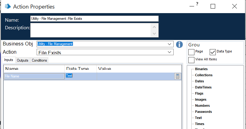

I moved the selected file from one folder to other after that i have created a decision stage to give result as success, though the file is moved in decision stage i am getting false result.
Screen shot attached. Please can someone help to sort this issue

If you are able to move the file successfully, then you can just check for "File Exists" on the target folder for confirmation.

Hi Miya,
If file size is huge, you may face this issue.My suggestion : After moving the file to destination folder, check the moved file present or not in destination folder by using "File exists action".
It may resolve your issue.

Simply put a wait stage between 2 of the actions . When you are moving a file it takes some time (depending on file size) . Due to which the File exist action will return false as the file is not completely moved ,
