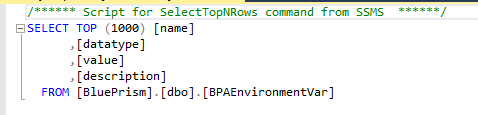

And the table name of the Environment Variable is "BPAEnvironmentVar" within the Blue Prism SQL database.

It would not be a good approach to touch and update the BluePrism DB directly to change EVs.
I would suggest using an alternative approach such as the use of Configuration Files. Config files are really helpful when you expect values to be updated with the passage of time.
Check out this  #BPTechTips on the same if that helps.
