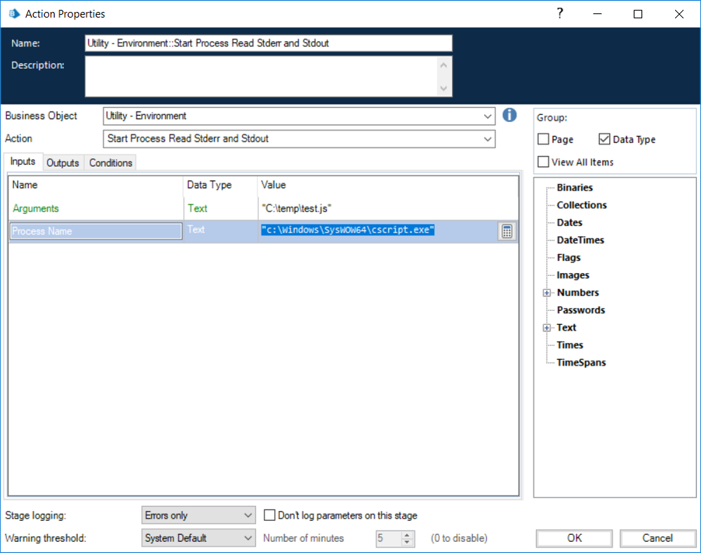

Ok, so lets trying something a little different. Instead of opening a command prompt from the DW and trying to run csript from it change your Start Process call in the Utility - Environment VBO to just reference "c:\Windows\SysWOW64\cscript.exe" as the process name. Then pass in your parameters under the Arguments input. So it would look something like this:
NOTE: I'm using Start Process Read Stderr and Stdout so I can see what the result is.
MarcusAllen
@ewilson Thank you for the image. Seems like I need to update the object because I do not have that option. That could be an issue right there. Let me see about getting an update and then try to run that bot.​
ewilson
Ah, that could be an issue, but I’m not certain. This is the latest version of the VBO that’s available from the Digital Exchange.
