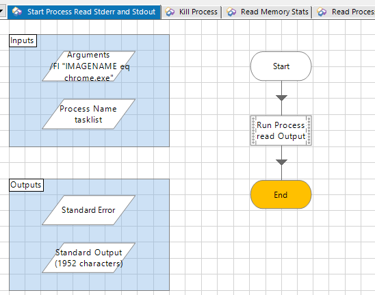

There are several approaches, depending which programming technique you prefer.
One option is to use old style cmd line, which might be easier if you are not too deep into programming:
tasklist /FI "STATUS eq NOT RESPONDING" /FI "IMAGENAME eq chrome.exe"
You might have to add some steps to catch and parse the results and exclude filtered results from non-existing processes.
I am sure there is something similar (very likely better) in PowerShell.

Using CMD linetasklist /FI "STATUS eq NOT RESPONDING" /FI "IMAGENAME eq chrome.exe"
After some particular actions from BP I would like to poll the status every 5 seconds and loop until status <> "Not Responding". BP will handle kill process logic based off max loop. I think using CMD would be causing my system a hassle, and BP as I'd be shifting active windows; either using CMD itself, or Windows "Run" program.
I think coding is the cleanest way, as the system is aware of the responsiveness with or without Task Manager open, meaning I should be able to poll and call the current status without opening any additional applications.

You'll also be able to try Walter's suggestion with a silent call using the Utility Environment VBO
