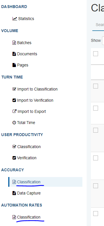

The two reports about the classification that I am taking about:
