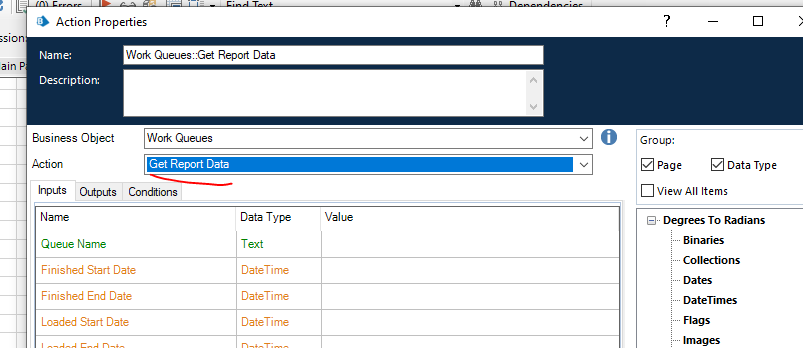

Which VBO/Asset are useful for Control Room data reporting and MI Reporting purpose for blue prism business users.
Which VBOs/Assets are useful for Control Room data reporting and MI Reporting purpose for blue prism business users.
Need suggestions.

One very helpful internal action is the Get report data under Work Queues
Harshit Rawat
Senior RPA Consultant
