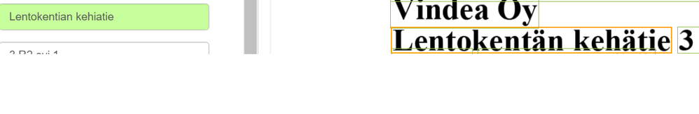

I have around 10+  documents but still Decipher not  remembering  the region setting what i have done why ? let me explain in details
  1. .I have set Primary language as Finish for finish document
  2. Pushed  to Decipher and mapped
  3. a name which come is finish is not  marked in filed. It marked as below
  4. Then I have resized the area  and then i got correctly
  5. after summation i have pushed other docs like 9 more . but Decipher  marked all the times wrongly as #4
  6. is it any issue with Decipher  capture ?   or I am doing any thing wrong or missing some thing ?
a different customer document (same language)   processed 30+ but still same issue as above
Any light on this please ?

Thanks Ben,
Yes I have trained in  the manner what you suggest
  1. DFD  Document type and Batch created and mapped  ( ML disabled)
  2. Processed one  documents checked in Data Verification ( Corrected the word  by re-sizing the region  which identified wrongly  as mentioned in image-1)

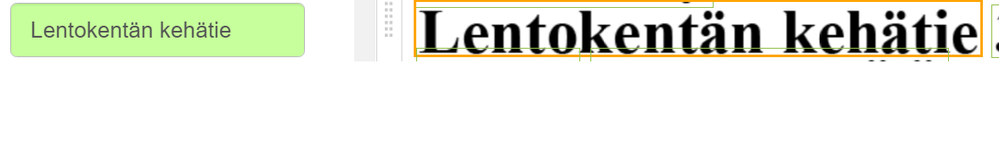

  3. Ensured i got correct value as in Image-2 , then  Submit
  4. Repeated the steps 2 and 3 for other 9 documents one after other
  5. At 10 th document also i see same issue
Please suggest me if I am wrong in these steps.. as there is no changes require i have not return the batch and made any changes in DFD ...
