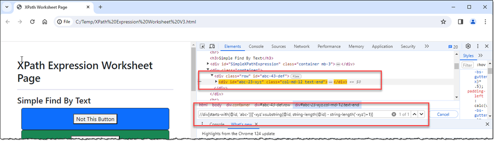

You could always use the XPath AND equivalent and the workaround for ends-with (another thing that does not exist in XPath v1.0). Something, for your example, like the following would work:
//div[starts-with(@id, 'abc-')]['-xyz'=substring(@id, string-length(@id) - string-length('-xyz')+1)]
Putting two or more filters together works like an AND.
The really ugly stuff is the workaround for the ends-with function which simply compares the text you want at the end of the id with a substring of the end of an id.

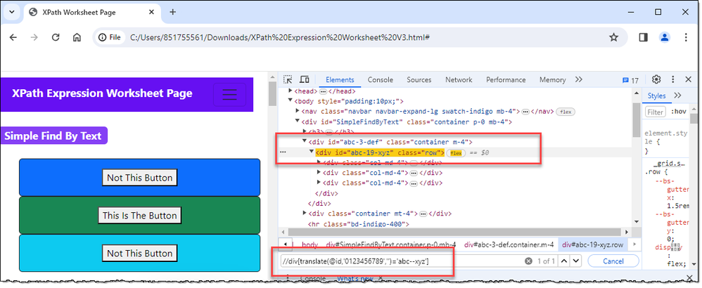

Sorry to dwell on this but this morning another solution popped into my head (I have to get a life). You could also use the following for your example:
//div[translate(@id,'0123456789','')='abc--xyz']It is simpler because it just removes all the numbers out of the string for comparison.
