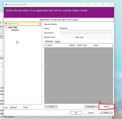

hello! i just started my path with the learning license and when i click "attach" in data modeller the tool gets stuck evreytime i have to finalize blueprism from task administrator.

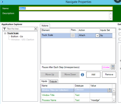

At first you have to launch application or url then you can attach
click application modeller > configure the type of application u want to work on ->Launch
in my case application is msedge so i have given process name as msedge
hi, thanks for your answer but what i mean there is a bug in my version because when i try to launch the buttom is stuck. i cant even close the application i have to finalice task from manager.

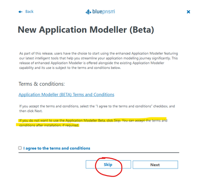

i uninstall an reinstall again blue rpism without an option for data modeller BETA
at least now i have an answer but again an error

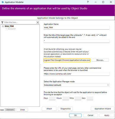

I was asking if you could click on the Web_Trm element in your application modeller window, and post a screenshot to show us how the application is configured:
Andrzej Silarow
hi! sorry for confusion here you go
asilarow
Right... so looks like you have it set up as a browser application, which normally would be fine... if not for latest updates to chromium.
Try changing the application type from browser based, to windows application, and provide the url in the command line parameters.
This will allow you to successfully launch the application, however will disable the web spying mode.
To be able to use web spying, you will need to create another object, which will attach to the already existing browser.
Hopefully this makes sense... if not let me know, and i will guide you further with more detailed steps.

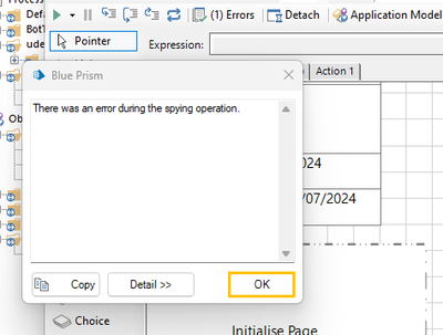

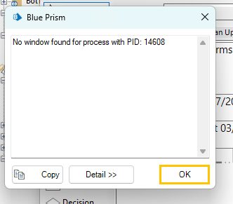

i have changed the method to windows application. now blue prism show me this
and when i select the option open UI show me this error
but the webpage is already open by itself
even attaching other url is giving me other errors neither could spy
