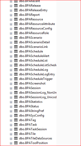

You are right, I want to get a list of "schedule definitions".
If possible, I would like to extract "what is scheduled for a given time period" and "what are the settings for that schedule", which I can get by filtering it once I get the "entire schedule definition".
Future schedules can be calculated based on that.

18-12-23 02:34 AM
Leonardo Soares
RPA Developer Tech Leader
Bridge Consulting
América/Brazil
