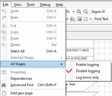

when you do edit>all stages> any of the option and save the process/object, where to find this information in Blue prism GUI
in version history comparison - it is not showing.
in the audit logs - it is showing that user has modified the option.

Hello Neeraj,
Version Compare - Log setting changes are not included so it shows no differences.
Blue Prism GUI - Only can be checked by clicking every stage because in the menu it does not show any sort of check mark or something to indicate what is the current log setting on the process/object.
Audit Logs - I could not find an entry for log-level changes in System > Audit logs
A good candidate for ideation and a required feature for sure.

Exactly Tejaskumar Darji - there must be an area where logs are maintained for changes done for logging.

@Neeraj Kumar - Similar findings as of @Tejaskumar_Darji and I would agree with Tejas on the ideation part.
