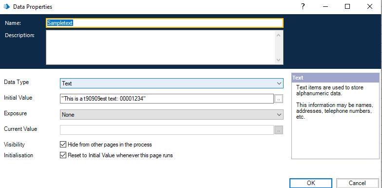

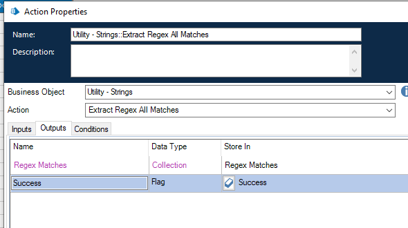

Hi @lulis
Can you specify the context a little bit more on what you are trying to achieve?
Normally utility Strings solves the purpose.
In this example below it extracts all the numbers from a sample text and puts them into a collection.
Depending on business scenario, the required regex pattern should be used.
Sample regex patterns can be found in the below link
JavaScript RegExp Reference (w3schools.com)
If you find the answer useful, you can mark as best solution.
