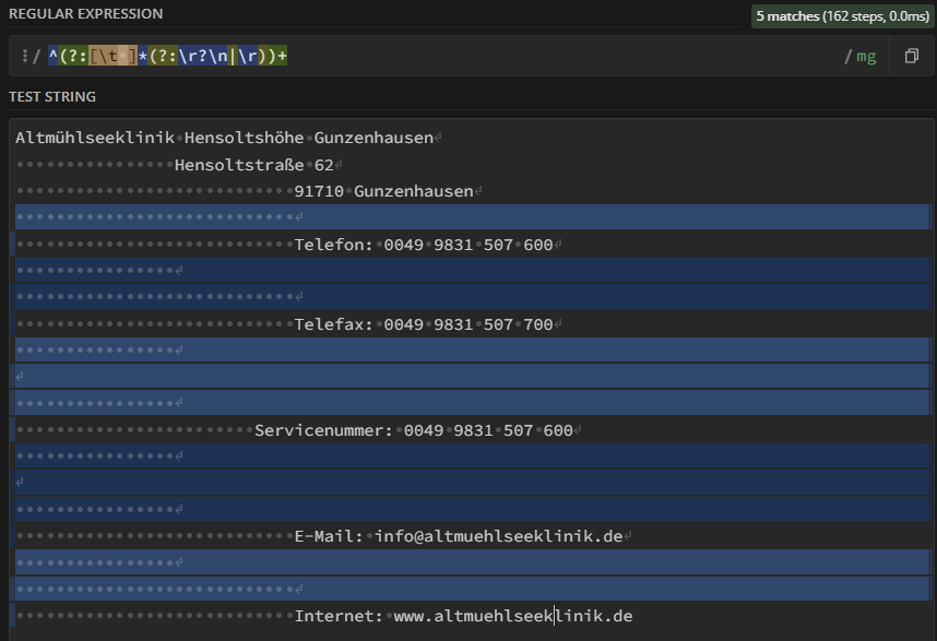

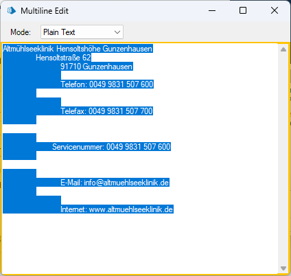

I used blueprism to get html code of a website. I used standard string operations like replace and regex etc. to modify the html to get a result like this:
I would like to "trim" every single line of the string and remove the lines that have no characters but I'm not able to do it.

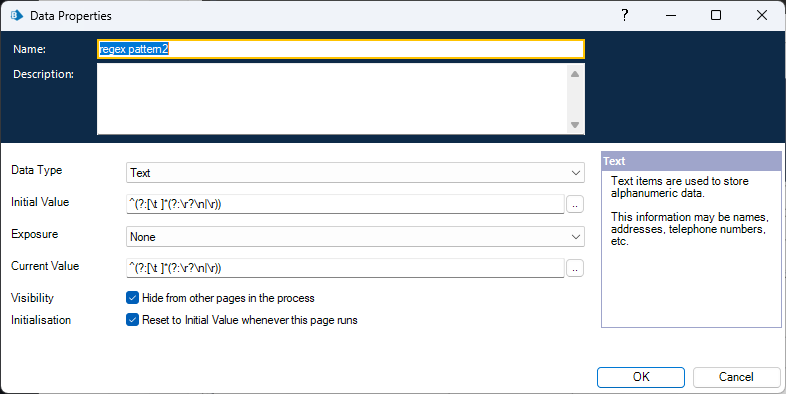

I thought about a regex replace but somehow I can not get the regular expression right. I use the AVO.regex and tried to use some stuff i found on google which seems to work on regex101:
35900.pngheres the way i built it:
Anyone got an idea how I could manipulate the string?

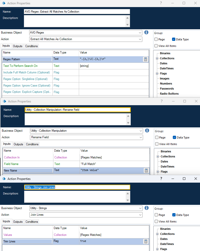

I found a solution now:
I make a regex serach for all lines that have content and put them in a collection. Then I juse join lines with that collection and get a string without empty lines. After that I have to rename the collection field because the  join lines action expects a collection with that field name.

I managed to trim every line with
[ ]{2,}
as input for the regex pattern but still can't get rid of the empty lines.

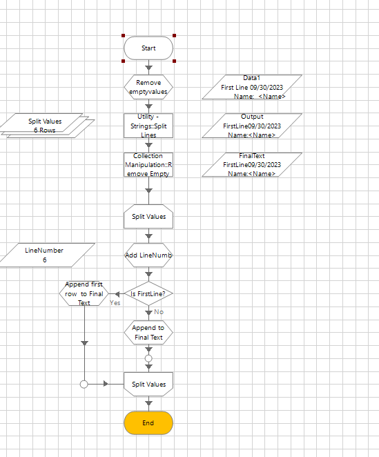

Hi Marco Matuttis,
1) If you want to just replace new line and append all text  you can use Replace([Data1], NewlIne(),"")
Data1=
 First Line 09/30/2023
               Adress: <Address>
             Telephone: 000378932
            Terlrphone" 238930303
          ServiceNumber: q23425093509285095

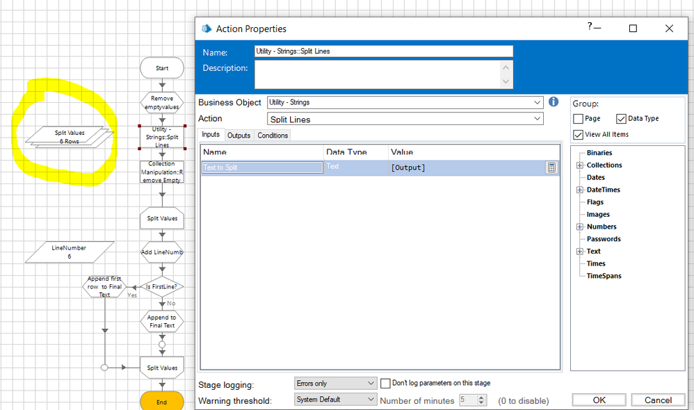

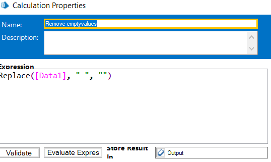

2) If you want to just remove the empty lines and keep the text as is. you can try  Below steps:
Step1: Replace([Data1], " ", "")

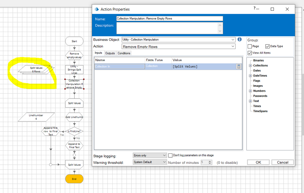

Step2: Split Lines
Step3: Remove empty rows
35895.pngStep4: check it is first row/Line >
if it is first row just add the split value text to final text
Step5:  your calculation stage looks like this if it is other than 2nd row
[FinalText]&NewLine()&[Split Values.Value]

MarcoMatuttis
