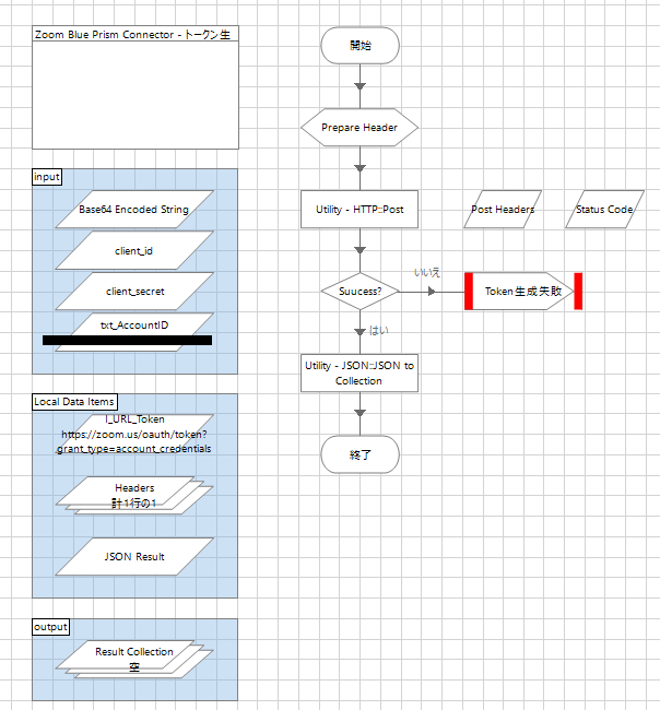

First, I created a "Server-to-Server OAuth" app in the Zoom Marketplace.
Then I created a VBO to get Token using client id and client secret.
This worked and I was able to get the Token.

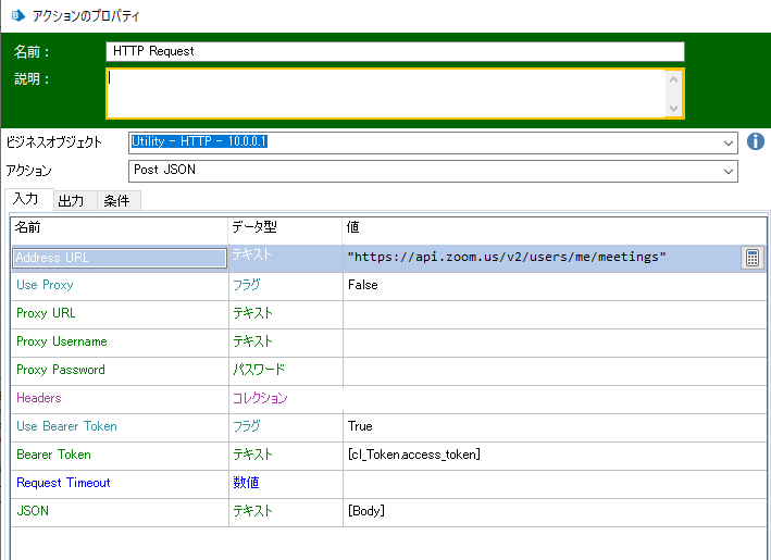

However, I cannot use this Token to set up a Zoom meeting.
It returns "400 Bad Request".
In the same environment, I was able to set up a meeting in Python using this application.
Below is a screenshot of the "Post JSON" action of the "Utility - HTTP" VBO.
JSON is:
    "topic": "SampleMeeting",
    "start_time": "2024-01-06T13:00:00",
    "duration": 60,
    "timezone": "Asia/Tokyo",
Please advise me where to find the cause of the problem.

LeonardoSQueiroz
Level 10
Check that the , in the "," syntax at the end of the json cannot be impacting.
Try this and see if it works.
     "duration": 60,

Hello @LeonardoSQueiroz,
Thank you, it worked, so I could create a VBO.
But it don't work if it is nested:
     "duration": 60,
     "settings": {
          "host_video", True
What is wrong with the nested structure I wrote?

Hi Mitsuko,
In the provided JSON, there's a syntax error in the "settings" section. The colon (":") should be used instead of a comma (",") for specifying key-value pairs within the "settings" object.
Try using the below JSON.
     "duration": 60,
     "settings": {
          "host_video": true
I hope it will resolve the issue.
