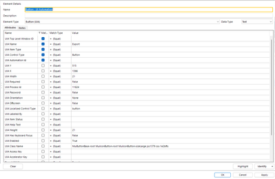

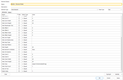

Hi, here is the attributes I am getting after spying in browser mode:
and here is the attributes I get after spying with UI Automation:
neither have been fixed - this is just the default attributes I get from both options, directly after spying

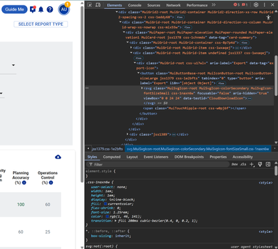

Hi @Mohamad_Dakkouri,
here is the html code for the button

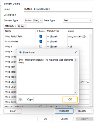

Do something like this :
Tick only Web Path/Xpath and the match index.
Put this expression for Web Path/Xpath : //svg[contains(@class,"MuiSvgIcon-root")]/parent::button[@type="button" and @aria-label="Export"]
for Match Index put

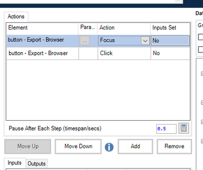

Use then navigate stage and provide this :
try it and let me know

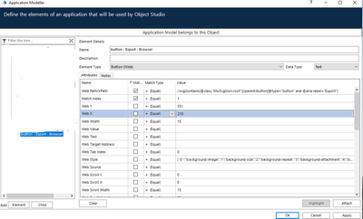

I made sure I put it in exactly correct but unfortunately got an error:
@rebeccabowe
Go to the html code and click Ctrl+f then paste the expression that i have send and see if you can find something please
I got it working - I copied the XPath from the inspect and pasted it in and now I have it fully working in Control Room - I was able to complete it 5 times successfully! Thank you for all your help!
Dear @rebeccabowe ,
I'm happy to hear you that it worked for you but when I look into your Xapth path I'm a bit worried if the div number get changed in future.
Normally the syntax for the Xpath looks like this //button[@id="root"]
When you work with the Xpath and CSS Selectors I would recommend to not use Match Index .
Please reach out to us if you need any help on this
Could you please try this Xpaths //svg[@data-testid="CloudDownloadIcon"] or //button[@aria-label="Export"]
Cheers 烙易
Hi, @rebeccabowe ,
Use AA mode to handle this scenario. If it is a Web based application change to Windows first in App modeler & try to spy the element with AA & change back to web based. It will works fine & handle the different modes by exception handling. Please let me know if you face any issues & i can help you on this.
I tried the //button[@aria-label="Export"] XPath and it worked! Thank you for all your help!
