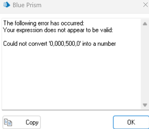

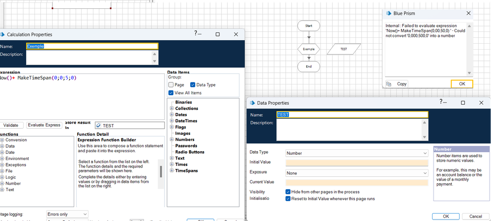

How could it be possible to have an error while others with the same code have no error?
Now()+ MakeTimeSpan(0,0,5,0)
The following error has occurred:
Your expression does not appear to be valid:
Could not convert '0,000,500,0' into a number
33644.png Thank you!

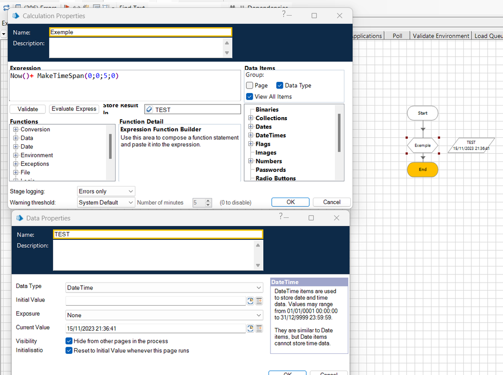

LeonardoSQueiroz
Level 10
What is the format of the data item? When I changed it to Datetime, no error occurred:
Scenario 01:
Scenario 2:

is working! many thanks
sahar Salehi
