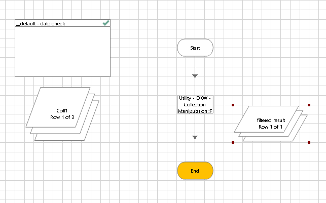

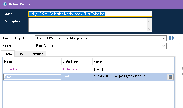

Think you're looking for something like the filter collection action inside of collection manipulation.
the syntax is basically [filter name] = 'some value' to get what you want.
here is an example
top level view
each stage
(this is a custom object but the action exists in the normal collection manipulation)
note the query syntax.

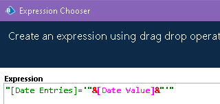

inside the single quotes I have hardcoded a value but you may want to use a variable which would be like this:

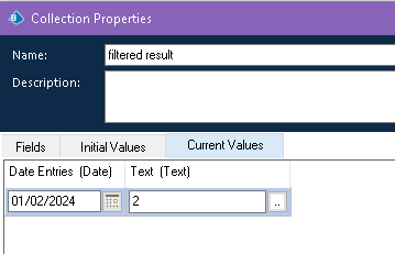

result post filter inside another collection that you can then use. if no values are found the collection will contain zero rows

07-03-24 03:32 PM
Hi Sudha.
here is an example
top level view
each stage
