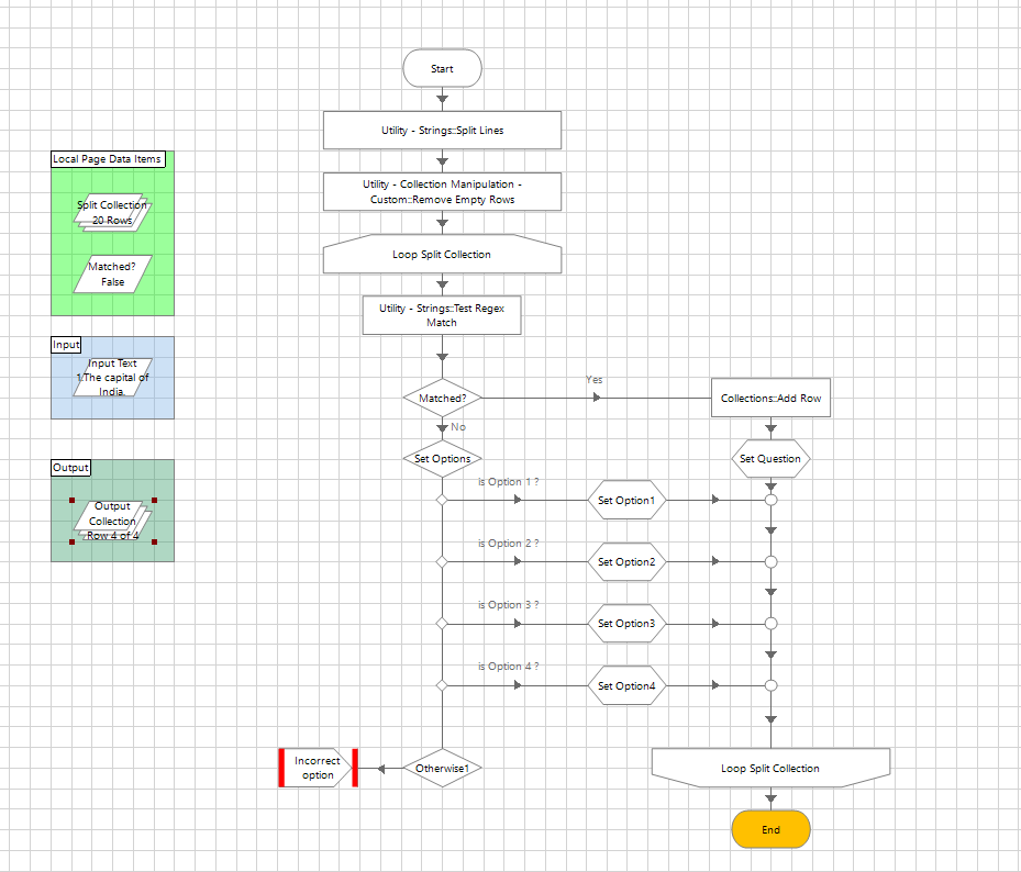

The easiest way to achieve this without a code stage is by using the BP VBO's such as Strings & Collection Manipulation.
Steps:
  • Use split lines action from Utility - Strings to convert the text into collection.
  • Use Remove Empty Rows action from Utility - Collection Manipulation to remove any empty rows.
  • Loop the output collection obtained in the above stage.

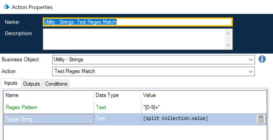

  • Check if the incoming row has any numbers in the text using regex match (Assuming the question value has a number. Based on the input string you can modify the regular expression) 32803.png

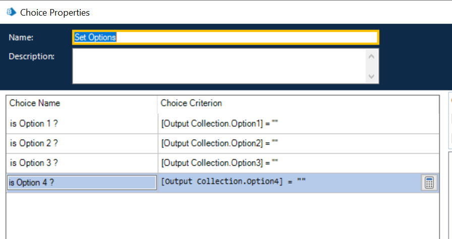

  • If matched, then add a new row to the output collection and set the incoming value as question in the output collection.
  • if not matched, then the set the incoming string as option in the output collection. Use the choice stage and set the options in the output collection accordingly. 32804.png

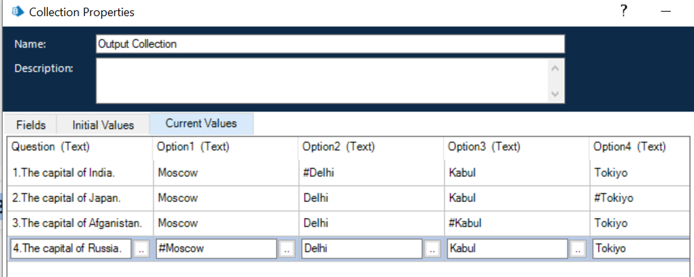

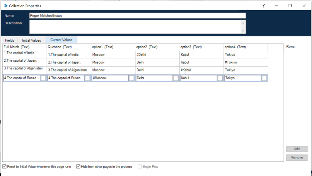

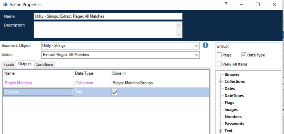

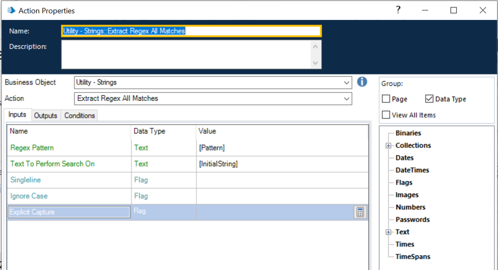

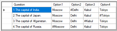

plnarayana777
Hi
it is not code stage but another simple way
Here "Pattern" is regex pattern
(?<Question>\d+.*)[\r?\n]*(?<option1>.*)[\r?\n]*(?<option2>.*)[\r?\n]*(?<option3>.*)[\r?\n]*(?<option4>.*)
Initial string  is your string
Output is just undefined collection
will get output collection

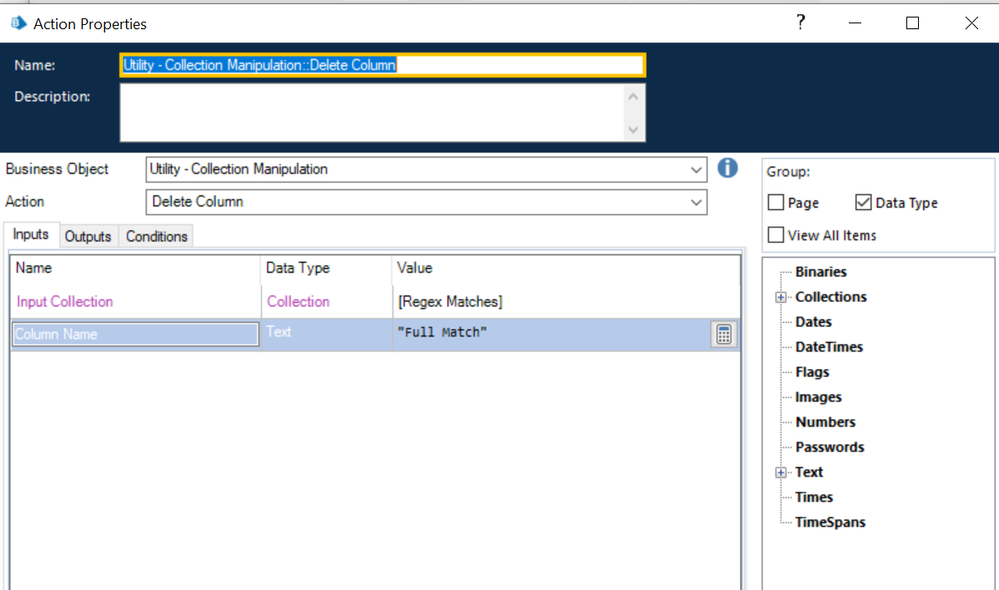

you can remove first column as below
Provide collection name and column name you want to delete
