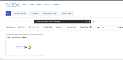

Also,I was not able to see the aforementioned vbo Collection Manipulation Extended on the Dx portal so as to use the action extract duplicate.

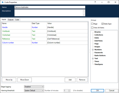

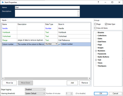

The code is shown below. As for removing text and whitespace, i would keep that simple and use a formula to do that. In a blank row add a formula similar to =TRIM(SUBSTITUTE(SUBSTITUTE(A1,".","",1),",","",1))
Dim wb, ws As Object
Dim excel, sheet, range As Object
wb = GetWorkbook(Handle, Workbook)
ws = GetWorksheet(Handle, Workbook, Worksheet)
wb.Activate()
ws.Activate()
excel = ws.Application
sheet = excel.ActiveSheet
range = sheet.Range(Reference)
range.Select()
ws.Range(Reference).RemoveDuplicates (Columns:=Column_number, Header:= 2)
