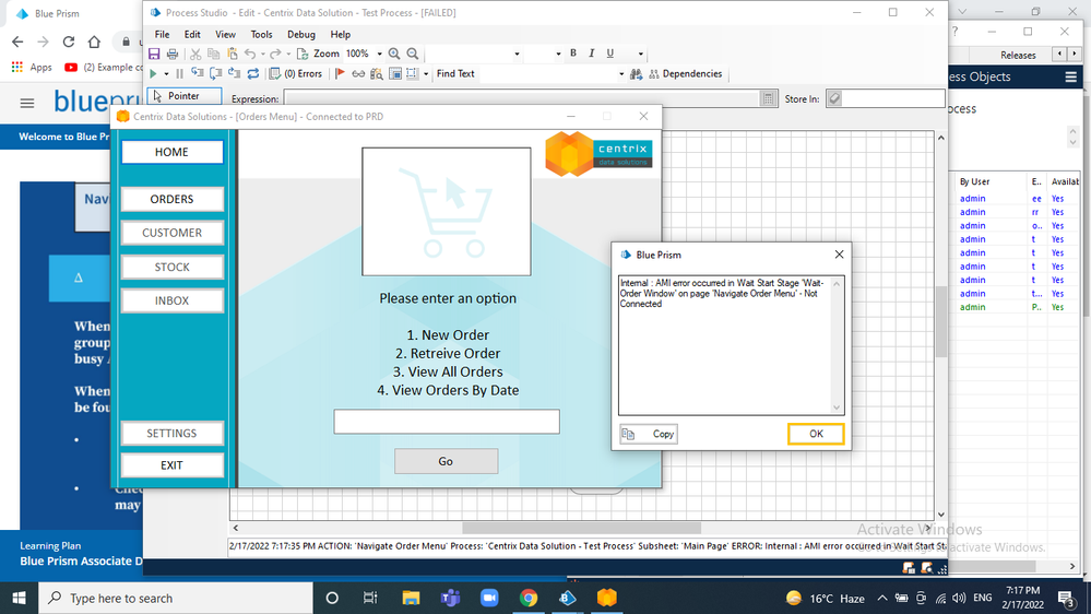

Internal : AMI error occurred in Wait Start Stage 'Wait- Order Window' on page 'Navigate Order Menu' - Not Connected

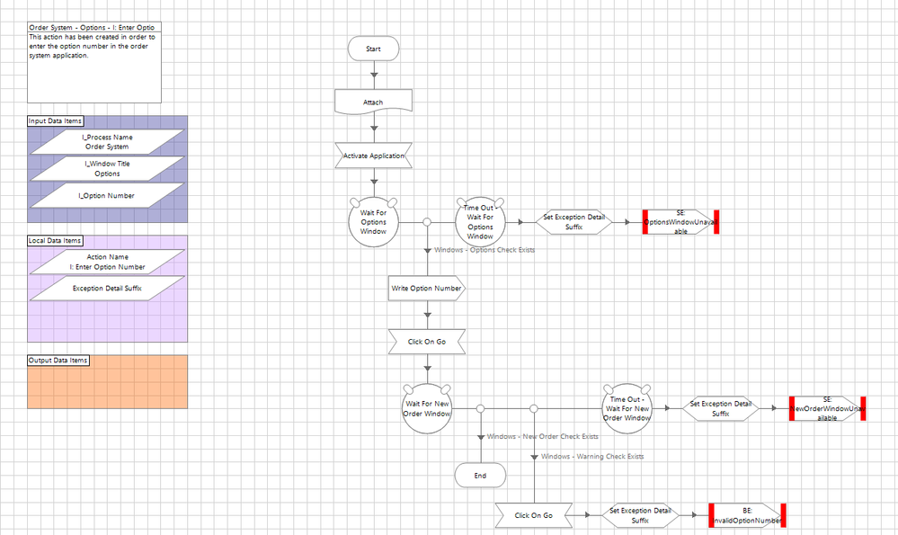

this error occurs in the level of entering 1 as new order into the option box, even though it's the same way as entering log in info

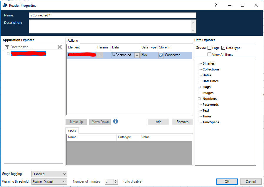

You can use a "Read" stage to check if is correctly attached:

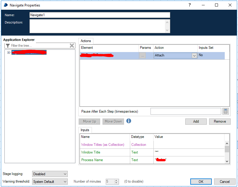

If is not attached, use a "Navigation" stage to attach the window

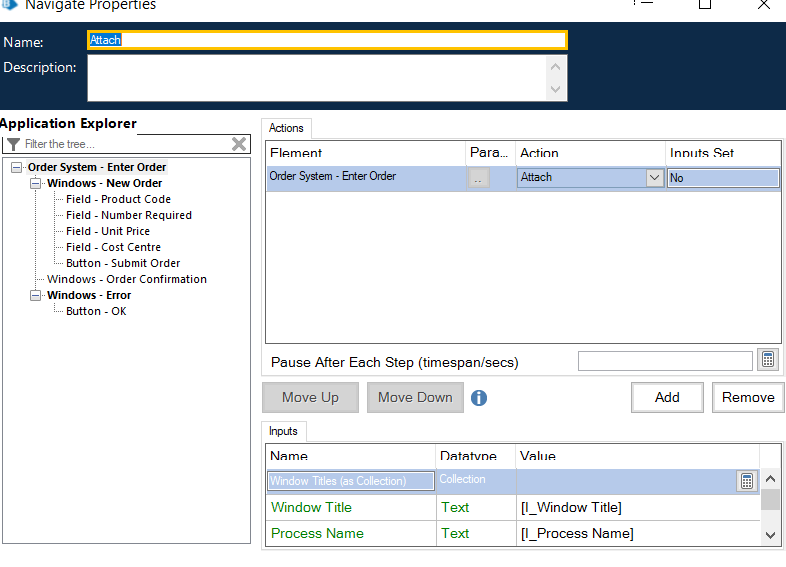

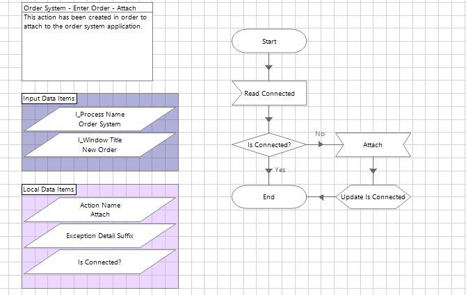

This error is most like caused due to attach issue with the application, try to create an attach page with the following template as shown below:
In you 'Enter Order Number' action, remember to call this page once before executing your actual sequence as shown below:
This should most likely fix your issue.
