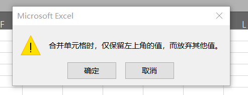

您好,非常感谢您的帮助,这个方法确实可以实现合并单元格,但是Excel会弹出这个窗口会导致流程终止,可以麻烦您,这个怎么处理吗,非常感谢,谢谢!

Are you using the method specifically as @Michael ONeil  described it above, or are you using the updated VBO from the DX? In the VBO, we added the following additional line before the merge:
Application.DisplayAlerts = False

我使用了@Michael ONeil的方法, 没有使用DX

@ZejunSun,
Go to the following link, sign into the DX, and then download the latest MS Excel VBO bprelease file. Once you've downloaded that, you'll need to import it into your Blue Prism instance.
https://digitalexchange.blueprism.com/dx/entry/3439/solution/ms-excel-vbo
You do NOT have to reinstall Blue Prism.
