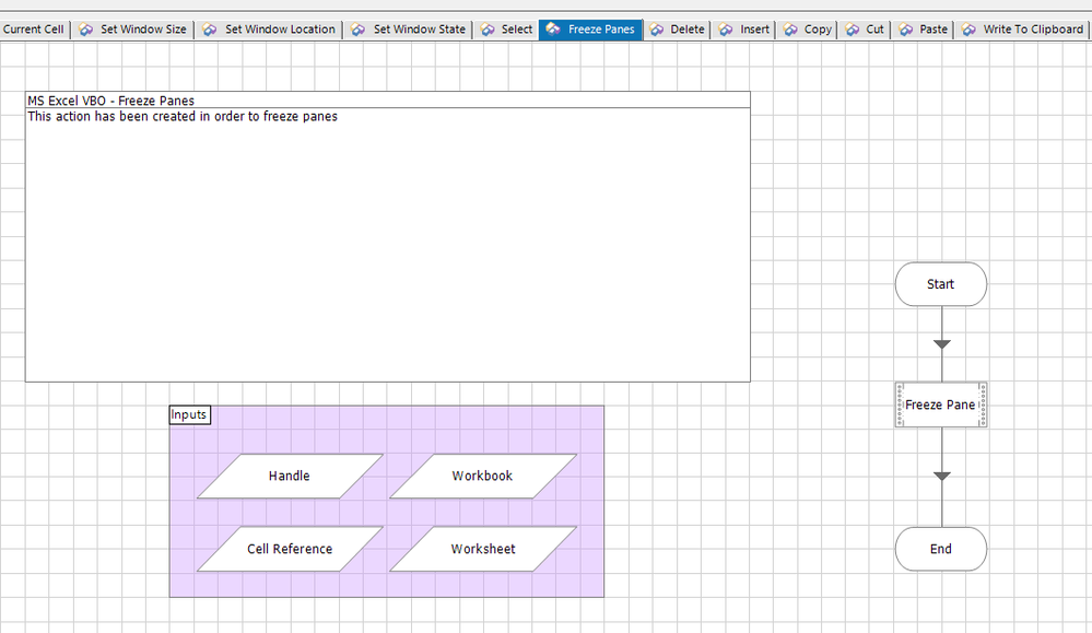

For your desired use case please follow the below steps to create a new action for performing the required operation.
NOTE: You should ideally create a duplicate business object for the same and do the required modifications so that the original business object is not affected and you can use it for reference.
Create a new action called 'Freeze Panes' within the 'MS Excel' VBO object which consists of other actions. Add the following input parameters to this action:
- Handle (Number) : The instance of the excel sessions held in the dictionary to establish the current excel connection.
- Workbook (Text) : The workbook name returned while using either 'Open Workbook' or 'Create Workbook' actions.
- Worksheet (Text) : The worksheet name where the operation needs to be performed.
- Cell Reference : The cell address from where the freeze pane action needs to be performed.
Solution Workflow:

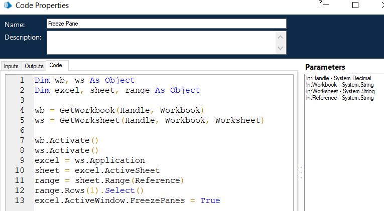

Add the code stage named 'Freeze Pane' with the following parameters and code:
Code:

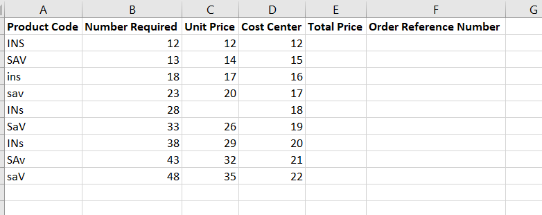

The input file before execution looks like below:
Upon executing the workflow, the results are as follows:
Here, the freeze pane has been added at the given cell reference.
Solution Workflow:
Code:
Dim wb, ws As Object
Dim excel, sheet, range As Object
wb = GetWorkbook(Handle, Workbook)
ws = GetWorksheet(Handle, Workbook, Worksheet)
wb.Activate()
ws.Activate()
excel = ws.Application
sheet = excel.ActiveSheet
range = sheet.Range(Reference)
range.Rows(1).Select()
excel.ActiveWindow.FreezePanes = True
