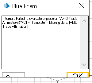

Hi BP developers, am working on automating a web application, and I seem to have encountered this error. I have tried for days to solve it, but; to no avail. Can someone help? Thank you

Can you confirm if [AMO Trade Affirmation] data item is created ?

Hi Sylvester,
There is possibility that trailing spaces are there in the data variable name which you have created.  So try to drag and drop the data item from right hand side from the data item section. In that way you can validate if it your data is created and have the correct name which you are entering.
Hope that helps.
