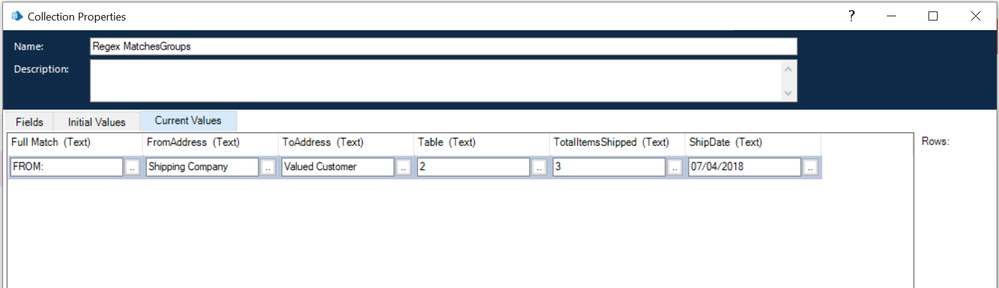

following regex you can use to get the grouping values
FROM:\s+(?<FromAddress>[\S\s]+)\s+TO:\s+(?<ToAddress>[\S\s]+)Quanity Ordered[\S\s]+Weight\s+(?<Table>[\S\s]+)Total Items Shipped:\s*(?<TotalItemsShipped>\d?)[\S\s]+Ship Date:\s(?<ShipDate>\d{2}\/\d{2}\/\d{4})
Here initial string is text from pdf
first use the above to get the groups data and along with table
will get output as collection as below
next step is to get table data present in Table column
will get the output as string
same way you can get all the values or even you can use multi calculation stage to get all the values at a time

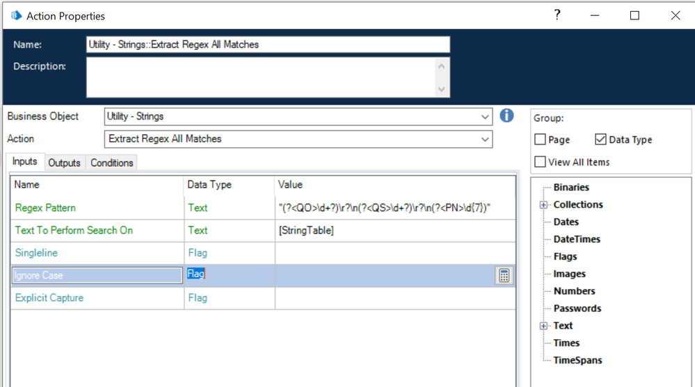

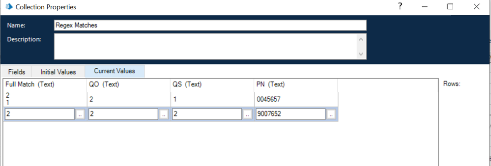

next use below regex to get table values
(?<QO>\d+?)\r?\n(?<QS>\d+?)\r?\n(?<PN>\d{7})
will get the values in collection , so based on your requirement you can get values through looping
