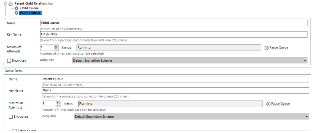

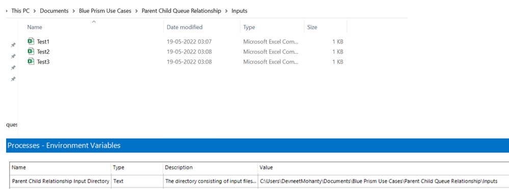

Hi @SamLima,
I have created a sample process​ exhibiting a basic parent-child queue relationship for you. In order to run this process successfully you need to place the input files somewhere in your local machine which are shown below and also setup the environment variable for the input directory as well:
Once this has been set up, ensure that you have the following queues set up in your environment:
Then you can run the process. All these artifacts are provided in the attach zip file for your reference. Do let me know in case of any queries.

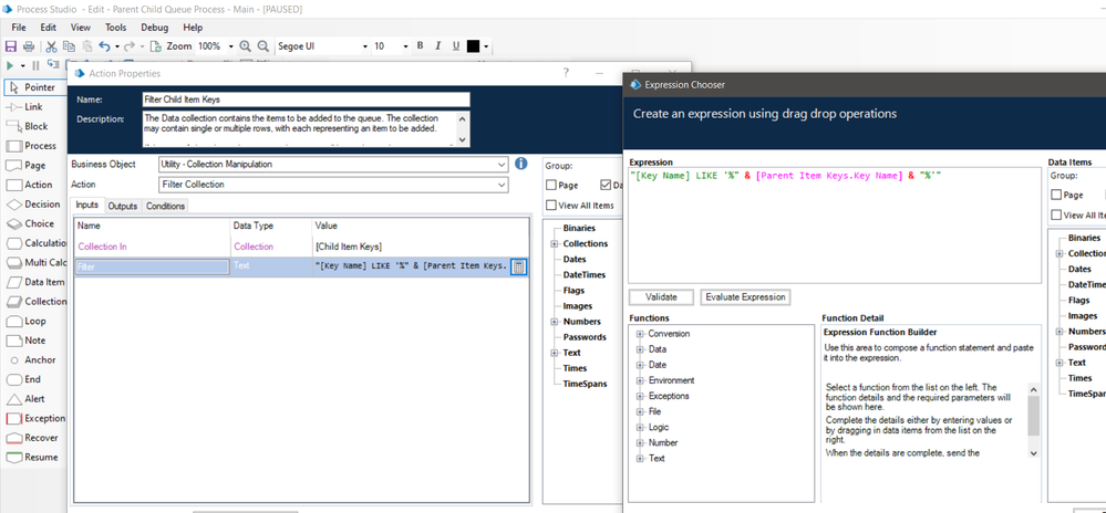

Thank you so much @devneetmohanty07, Could you please explain Mark Parent Queue Items As Completed page?
and what is this expression ?
Sam Lima
Here I am checking if any of the pending child items are available having the current parent key text included inside them or not. Ideally, if a blank collection is returned it means that we do not have any pending child items related to my current parent item and hence I can mark my parent item as completed.
Email: [email protected]
what is this expression?
Sam Lima
This is a filter expression, here basically if let say I have a collection called 'Child Item Keys' with a column called as 'Key Name' . So here I am checking if that column has the value of the current parent item key anywhere or not within it.
Suppose, the current parent key item is 'Test1' and the child item keys has following values:
'Test 1 - 1'
'Test 2 - 3'
'Test 3 - 1'
'Test 3 - 2'
'Test 3 - 3'
Then, only 'Test 1 -1' would be returned as it contains the keyword 'Test 1' within it
