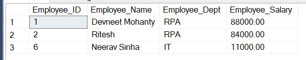

In my case I have a Employee database with majorly four columns: Employee ID (Auto incremented field), Employee Name, Employee Department and Employee Salary. Now what I essentially want is to only insert new records if the record is not already present in my table. Currently, this is how my table looks like:
