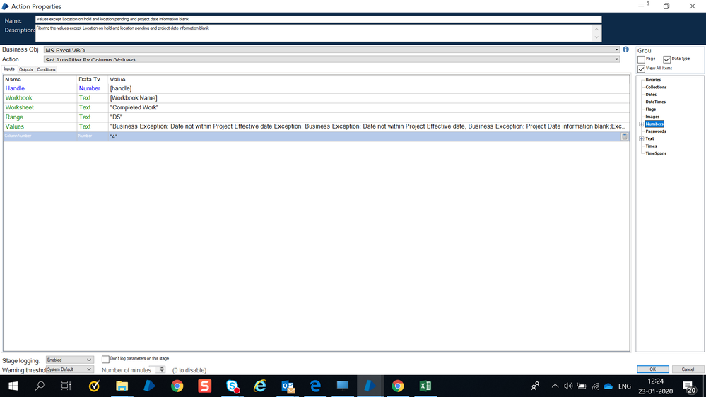

i am trying to filter one excel file but due to size of that item it's not getting filtered. Please help me to fix this code.

Please find the attached files

The Action- "Set Autofilter by Column (Values)" Doesn't seem to be an out of box action. Can you check if it's custom coded?.
If yes, Can you send the code for checking?

should i check this by going into ms exel vbo?
Sachinan Shahi
Dim wb, ws, excel,sheet As Object
Dim xlFilterValues as Integer = 7
Try
'Get WorkBook and WorkSheet wb = GetWorkbook(Handle, Workbook)
wb.Activate()
If Worksheet <> "" Then  ws = GetWorksheet(Handle, Workbook, Worksheet) ws.Activate() End If
excel = wb.Application sheet = excel.ActiveSheet sheet.Range(SelectedRange).AutoFilter(Field:=ColumnNumber, Criteria1:= ValueList.Split(","), Operator:=xlFilterValues)
Success = TrueCatch e As Exception Success = False Message = e.MessageFinally wb = Nothing ws = Nothing excel = Nothing sheet = NothingEnd Try
Sachinan Shahi
please help me in understanding the code
