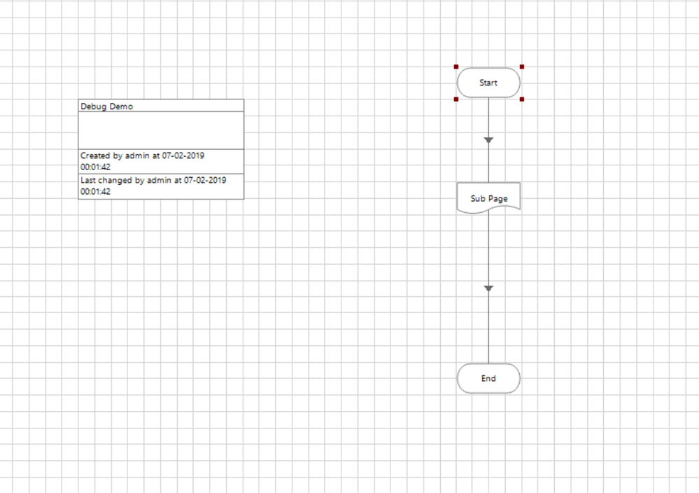

You can see that I have created the below workflow:
Main Page:
Sub Page:

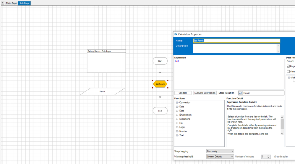

As you can see, in the sub page I am introducing an error in the calculation stage as I am dividing a number by 0 which would result in an arithmetic exception

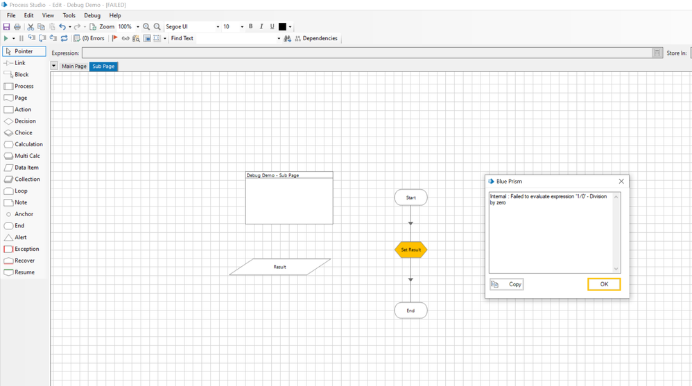

Whenever I try to either Step Out from Main Page or Step Over that page reference stage for sub page from my main page, my execution will halt at the calculation stage in error inside the sub page as shown below:
So to answer you question, no matter how you debug your workflow in no exception handling logic has been used your process would halt and be in Failed state whenever an exception occurs in any sub page and the control would be at the stage which is having the exception
Main Page:
Sub Page:
