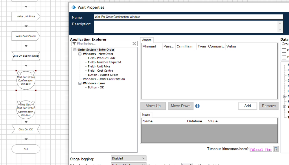

You should be using Conditional Wait wherever possible. Conditional waits are used for dynamically determining if an element exists or not for the specified element in you Application Tree at the runtime. Since in a DEV environment and in a PROD environment, the target application to be automated can have different loading times, we specify a maximum time out indicating that within that time if the element exists then, we need to move ahead or throw a time out. Below is the example of a conditional wait:
