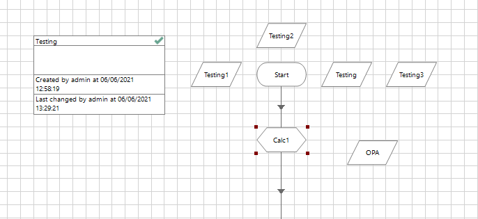

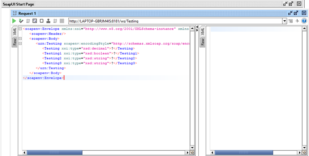

But basically there are SOAP Web Services and REST FULL, it would be a good start to understand how they work, today you can make a process blue prism behave like a SOAP that can be called through an end point, such as this process: it needs to receive some information and assemble a string:
So I exposed it on my part of the system and now I can make SOAP calls as I'll show below, passing the pass parameters through the endpoint: http://localhost:8181 /ws/Testing?Wsdl
