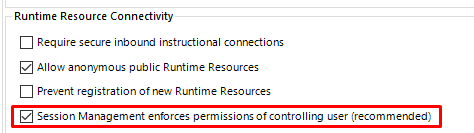

Hi Marco - is it related to this setting that was introduced between 6.4 and 6.10, and is enabled by default.
This is from the Help:
Session management enforces permissions of controlling user
Enabled by default. When enabled, when session control actions are requested the permissions of the controlling user will be validated. If disabled, the session control actions validate the permissions of the account used to authenticate the runtime resource against the environment.
It is recommended that this setting is enabled. When enabled, the create, start and delete resource pc commands are no longer valid. They are replaced by the commands: createas, startas, deleteas

Hi John, thank you for your reply, I'm not sure it applies to my case: I've the error just on authentication, far before asking for any other action.
I've tried without the flag, and the issue remains unaltered:
