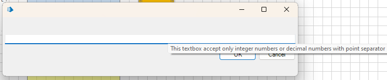

- Numbers (with the addition of a tooltip indicating what the input box provides as input and also the decimal separator to be used):
In this case, any literal or special character keys will not be entered (except for the correct decimal separator based on the region of use) as there is a class in the global code, called from the numbers form class that checks the keys pressed by the user and allows or disallows their entry into the textbox. - Filepath:

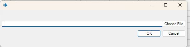

One case that might occur is to have an Input Dialog that gives the possibility of selecting a file and populating a text variable with the full path to the file.
For this reason, a button has been implemented that gives the possibility of selecting the file to load. - File Image:

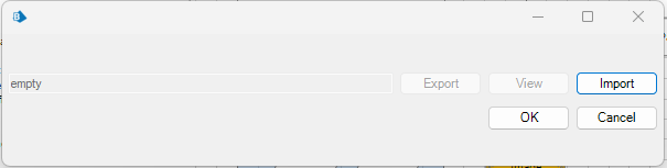

One of the Blue Prism types is the Image type and, inspired by the standard form of setting the image variable, the Export, View and Import buttons have been implemented, as well as a label that will be populated with the resolution of the loaded image.
By clicking the Import button and selecting the image, the Export and View buttons will be activated accordingly. Clicking the View button will give you a preview of the image file and the Export button will give you the option of exporting the image in the desired format.

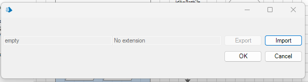

- File Binary:
Again, this is another data type in Blue Prism, and the same approach applies as for File Image, with the addition of a label identifying the extension of the loaded file.

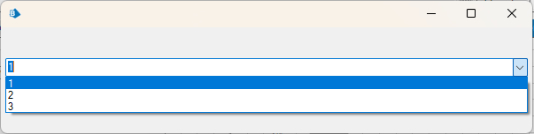

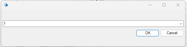

- Combo Box:
Sometimes we need to select a value from a list, then pass it as input.
In this example case we will pass a collection with three rows (1, 2, 3) and select the correct item, populating the output variable text.

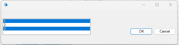

- List:
In contrast to the combo box, we sometimes need to select several values from a list provided as input.
In this case, the Input Dialog List comes to the rescue, resulting in a collection with all the selected rows.

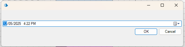

- Datetime
Further data from Blue Prism is the datetime type, so the form will have a calendar button where you can select from the correct date and the relative time. A corresponding variable will be populated.

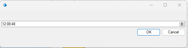

- Time
Same as the Date type, here we have the Time type. We create an input box where we can enter the desired time. In this case there is also a control on the values that can be changed by the arrows on the right - setting a range from 0 to 23 for hours, and from 0 to 59 for minutes and seconds.

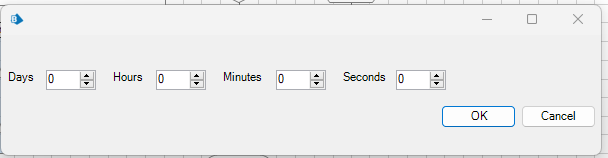

- TimeSpan
In Blue Prism, the data type TimeSpan is also present, so we have the possibility of choosing the days, hours, minutes and seconds that will populate the variable on Blue Prism.

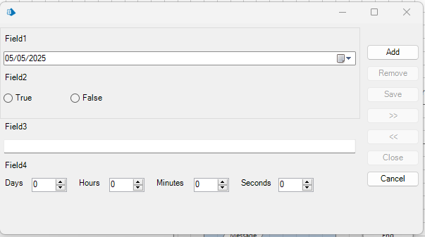

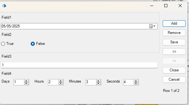

A dynamic form has also been implemented which relies on a collection in input with the type of data expected to be output.
In this case we have a Date, a Boolean, a Text and a TimeSpan.
Clicking on the Add button will add a row to the collection and consequently enable several buttons for managing the output collection.
Here we can see that the output collection has two rows. A Remove and Save button have been implemented, and the arrows allow the user to move from one row to another - displaying the values just entered on the screen.
The Save button is for modifying a row already inserted while the Remove button is for deleting rows from the output collection. Each Add, Remove or Save action is followed by a Message Box confirming that the action was completed.
When the Close button is clicked, the output collection is populated with the rows just inserted.
