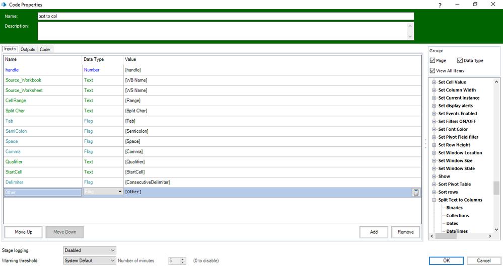

It looks like the text is being compressed to a single column delimited with a semi colon. There is an excel function text to columns that will resolve the issue but you need to create a new action in the excel VBO to do this. I've provided the code I use below and a screenshot of the inputs, hope this helps.
Dim wb, ws As Object
Dim excel, sheet, range As Object
Dim matrix = New Integer (3, 1) {{1, 1}, {2, 1}, {3, 1}, {4, 1}}
Try
wb = GetWorkbook(handle, Source_Workbook)
ws = GetWorksheet(handle, Source_Workbook, Source_Worksheet)
Wb. Activate()
Ws. Activate()
excel = ws. Application
sheet = excel. ActiveSheet
range = sheet. Range(CellRange)
range. Select()
Excel. DisplayAlerts = False
Excel. Selection.TextToColumns (Destination:=sheet. Range(StartCell), DataType:=1, _
        TextQualifier:=Qualifier, ConsecutiveDelimiter:=Delimiter, Tab:=Tab, _
        Semicolon:=SemiColon, Comma:=Comma, Space:=Space, Other:=Other, OtherChar _
        :=Split_Char, FieldInfo:=matrix, _
        TrailingMinusNumbers:=True)
Success = True
Catch e As Exception
Success = False
Message = e.Message
Finally
wb = Nothing
ws = Nothing
End Try

Hi Daniel
The inputs for the action should match the inputs for the code stage you created. This is where you pass in all the information required for the action to complete. In your case you need to provide the the handle, workbook, worksheet, cellrange (this is where the data is you need to split for example A1:A12), StartCell which should be the first row of the data range e.g. A1. The rest are mostly optional but you may want to set the Consecutive delimiter to false for Other set this as your delimiter ";". You should also provide the outputs for the code stage and action as Success and Message so you can check if there were any errors. If you are unsure about using this action you should try out the Text to Columns option within excel itself first to get a better understanding of the inputs of the vbo as this will match what excel does/requires. Also the split text to columns action should be before your Get worksheet as colleciton action.
