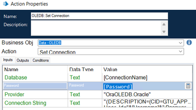

  1. OLEDB
Connection string: "(DESCRIPTION=(CID=GTU_APP)(ADDRESS_LIST=(ADDRESS=(PROTOCOL=TCP)(HOST="&[Hostname]&")(PORT="&[Port]&")))(CONNECT_DATA=(SID="&[ConnectionName]&")(SERVER=DEDICATED)));
User Id="&[Username]&";Password="&[Password]&";"
But it's throwing an error:
