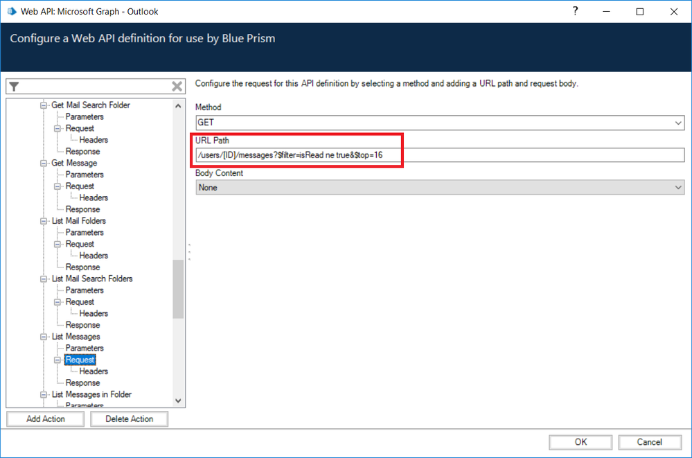

21-06-21 07:06 PM
Thanks Eric. Below are my pictures. Again, it appears that the issue is in how Blue Prism handles the result set since I get different results from different mail boxes.

Ah, I just got the error. So it's not really an issue with how Blue Prism handles the data per-se, but with how the underlying Newtonsoft library is trying to parse/convert the JSON into a DataTable that Blue Prism can then pass back to you as a Collection.
I'll have to research this a bit more.
