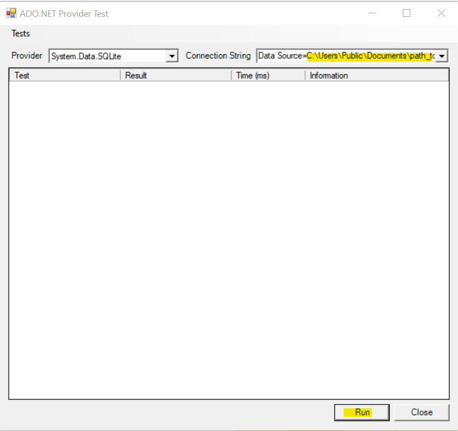

  1. Run the test.exe utility inside the folder that you unzipped in the preceding steps
  2. Update the connection string to include the full path to your database.
  3. In this case I'm using the sample chinook.db database downloaded from the SQLite web page and the connection string would look like this following the update to the database path
    Data Source=C:\Users\Public\Documents\DATABASE\sqlite3\db\chinook.db;Pooling=true;FailIfMissing=false
  4. Hit the Run button to test

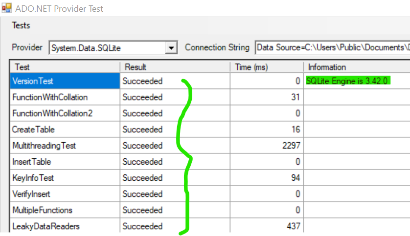

  5. Should the DLLs line up with your version of SQLite 3, then you must see along list of test results marked Succeeded as shown below (that also displays the exact version of SQLite 3 Engine)
  6. Copy the full connection string from the test.exe Connection String field as you will need it for testing further down below

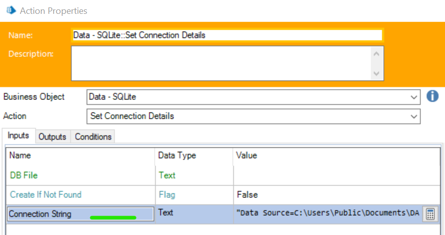

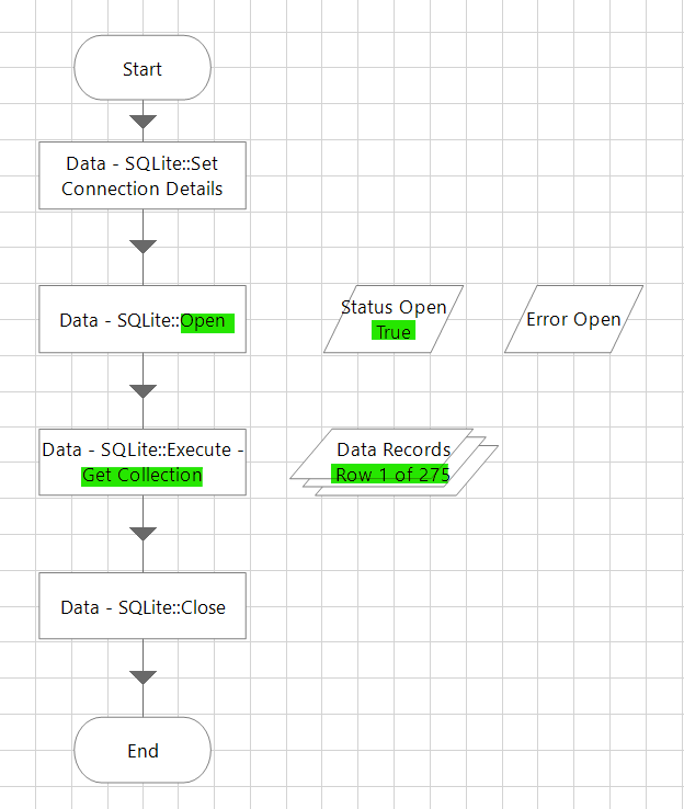

Here is the simple VBO that I created to test the impact of the solution. I used the Connection String option when connecting to the chinook database.  The connection string you copied from test.exe will come in handy here.
As seen from the Collection, 275 records were returned from the artists table
