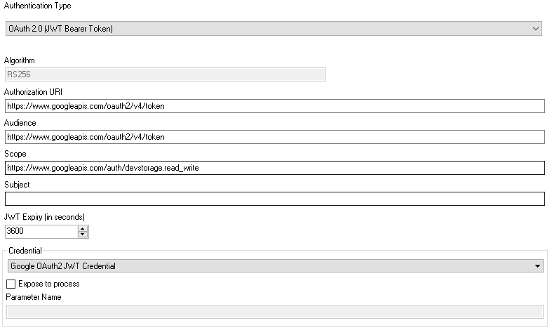

I'm having trouble getting the BigQuery Skill to work. More specifically I am receiving the following 403 error when trying to run the "BigQuery.datasets.get" action.
Internal : Unexpected error Error during Web API HTTP Request
HTTP Status Code: 403

My colleague on the BigQuery side has assured me that the service account should have all necessary permissions.
The OAuth credential has been setup following the API release notes:

Anyone experiencing the same issues or could guide me as to what specific permissions are needed for the service account in order to get this to work?
I haven't changed any of the default API authentication settings that came with the Skill.

Hi @Seb T,
I believe the Scope defined in the Common Authentication section is incorrect. Try changing it to:
https://www.googleapis.com/auth/bigquery
Eric

03-01-22 11:16 AM
Thank you very much.
