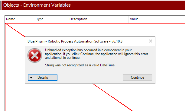

Looks like I spoke too soon anyway. I went back, and it seems that I am smarter than my past self and I just tried a few different string formats for inputs to setting date and date time. Here's a batch script that works for date, datetime, time, timespan, text, number, flag, password:
Ok, so it's super important that you get the strings EXACTLY in the right format when setting these. If you set one of these Date/Time-related environment variables incorrectly, your Environment Variables screen will look like below. Don't worry though. First, don't test this in a shared environment for the first time. Second, if this happens, you can delete the environment variables from the database pretty easily and no harm has been done.
Now that the warning is out of the way. It seems I cannot choose Batch as a language type for this code below. Don't be fooled. It's not VB even though I chose that. 😃 I left the username and password in the script on purpose. If anyone is reading this who isn't familiar with Batch or AutomateC commands, replace the "dave" values with your actual username and passwords if it's Blue Prism Native authentication. If you're using Blue Prism at an enterprise level, then you're probably using SSO. Replace "/user %username% %password%" with "/sso" if you authenticate with SSO.
